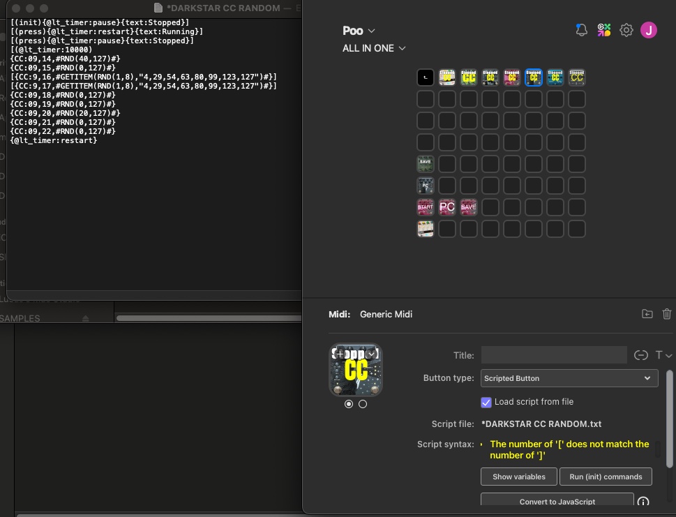

Everything is working but CC16 and 17. I want those specific CC values to randomize but cant get it working. I am a total newb im sorry in advance
[(init){@lt_timer :pause}{text:Stopped}]
[(press){@lt_timer :restart}{text:Running}]
[(press){@lt_timer :pause}{text:Stopped}]
[(@lt_timer :10000)
{CC:09,14,#RND (40,127)#}
{CC:09,15,#RND (0,127)#}
{CC:09,16,#GETITEM (4,29,54,63,80,99,123,127)#}
{CC:09,17,#GETITEM (4,29,54,63,80,99,123,127)#}
{CC:09,18,#RND (0,127)#}
{CC:09,19,#RND (0,127)#}
{CC:09,20,#RND (20,127)#}
{CC:09,21,#RND (0,127)#}
{CC:09,22,#RND (0,127)#}
{@lt_timer :restart}]

There is no randomness involved in CC 16 and 17.
If the intention is to randomly send one of the values in the list, you need something like this:
{CC:9,16,#GETITEM(RND(1,7),"29,54,63,80,99,123,127")#}]
I donβt know if the first item (4) is a part of the list or if itβs intended pΓ₯ be an index.
Thank you!
Yes sorry the 4 was meant to be a value. Here is where I ended up and it seems good:
[{CC:9,16,#GETITEM (RND(1,8),β4,29,54,63,80,99,123,127β)#}]
What you sent was missing the [ and I got the yellow warning on the button but once I put that at the front it was all good. I think. Iβll have to test more

I copied your line from your command. If you had replaced the line(s) in your command, the syntax would have been correct.
lxm9096:
This command will not do anything because it has no event to trigger it.
Sorry for the late reply. When I dont have the ] I am getting an error for the script.

To get your script correct, remove the β[ and β]β from the GETITEM rows, and add a β]β after the last row.
