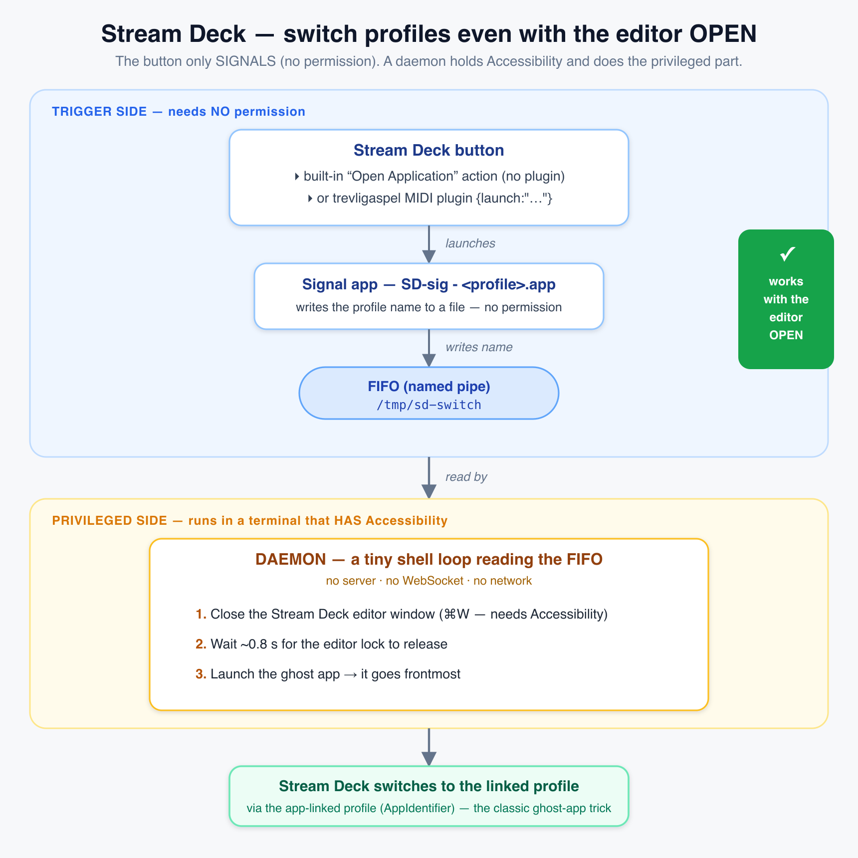

Why it’s hard
To switch while the editor is open you must first close the editor window (Cmd-W — Stream Deck stays alive in the menu bar; that lifts the lock). Closing a window programmatically needs macOS Accessibility permission — and here’s the trap I hit:
the little apps a Stream Deck button can launch are ad-hoc-signed, and ad-hoc AppleScript applets never get a working Accessibility grant on recent macOS. I verified it: count of windows returns -25211 even after enabling the app in System Settings, and a properly self-signed helper still failed to post the keystroke (1002). So the button itself can never close the editor.
The idea — decouple the trigger from the privileged action
  • The button only SIGNALS: it launches a tiny app that writes the profile name to a FIFO (/tmp/sd-switch). Writing a file needs no permission, so anything can do it.
  • A small daemon that does hold Accessibility — because it runs inside a terminal you granted Accessibility — reads the FIFO and does the privileged part: close the editor, wait a beat, then launch the ghost app (which switches the profile the usual way).
Bonus finding: a physical deck press fires its action even while the editor is open (the editor only intercepts software clicks on keys, not hardware presses). That’s why a signalling button works while you edit.
No server, no WebSocket, no network — the “daemon” is literally a shell loop reading a named pipe.
How to set it up
1) Grant your terminal Accessibility (this is the ONE manual step — a macOS security boundary, can’t be automated):
System Settings → Privacy & Security → Accessibility → enable Terminal (or iTerm).
2) Start the daemon (keep it running; a login LaunchAgent makes it permanent):
bin/sd-switch-daemon.sh          # watches /tmp/sd-switch
3) For each target profile, build two tiny apps:
bin/make-ghost-app.sh   "Live Set"   # jordikt's ghost app — bind it to the profile as usual
bin/make-signal-app.sh  "Live Set"   # the signal app the button launches
4) Wire a button to LAUNCH the signal app. Two ways, BOTH tested working with the editor open:
(a) From the MIDI plugin (a script) — “from scripts”:
[(press){launch:"/Users/you/Applications/SD-sig - Live Set.app"}]
(b) Without any plugin — “live”, base Stream Deck:
use the built-in “Open Application” action → pick SD-sig - Live Set.app.
Press the button (a), (b), or fire the MidiScript → the editor window closes and the deck switches, even though the editor was open. Same result from the command line too: echo "Live Set" > /tmp/sd-switch.
