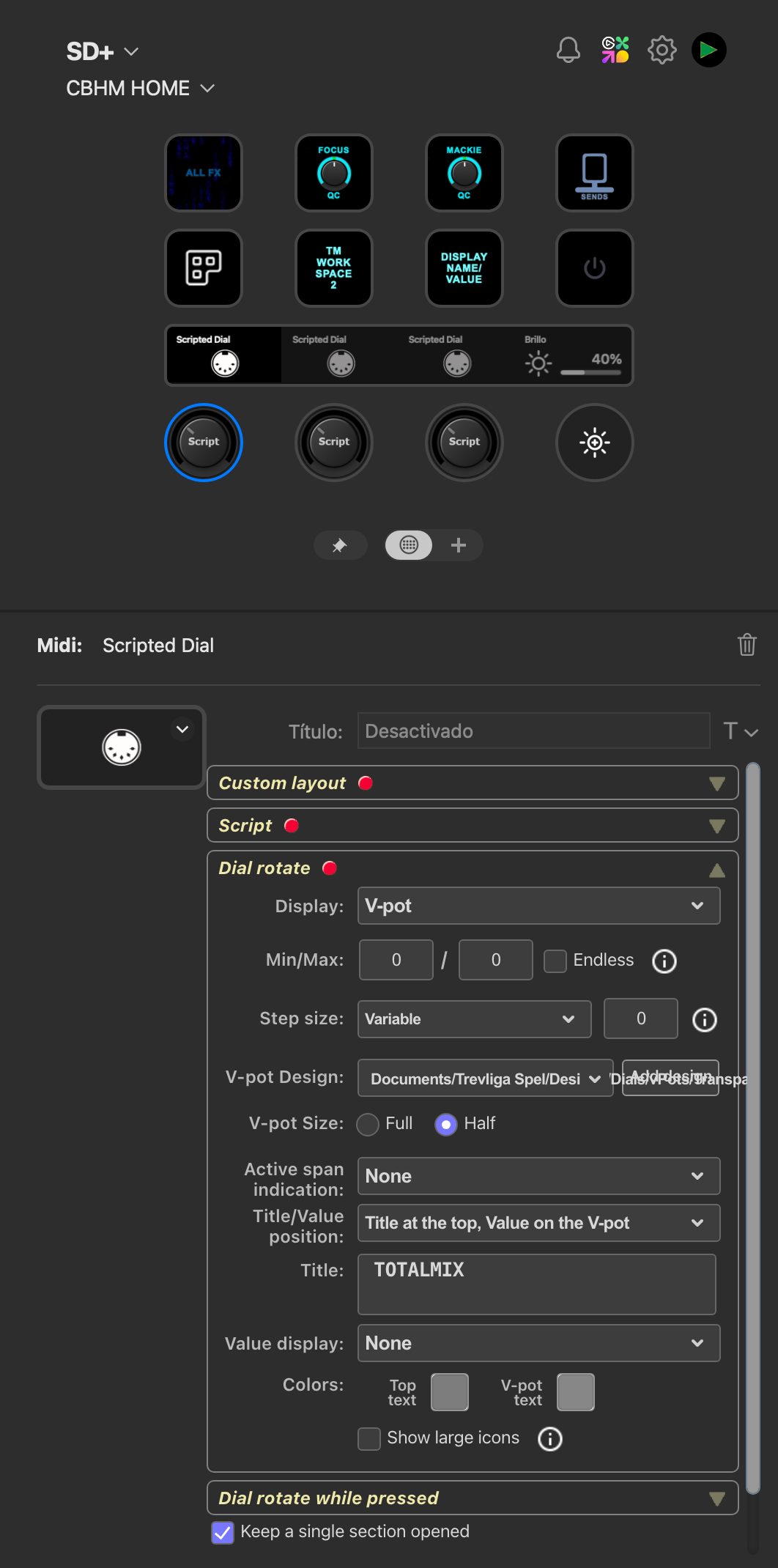

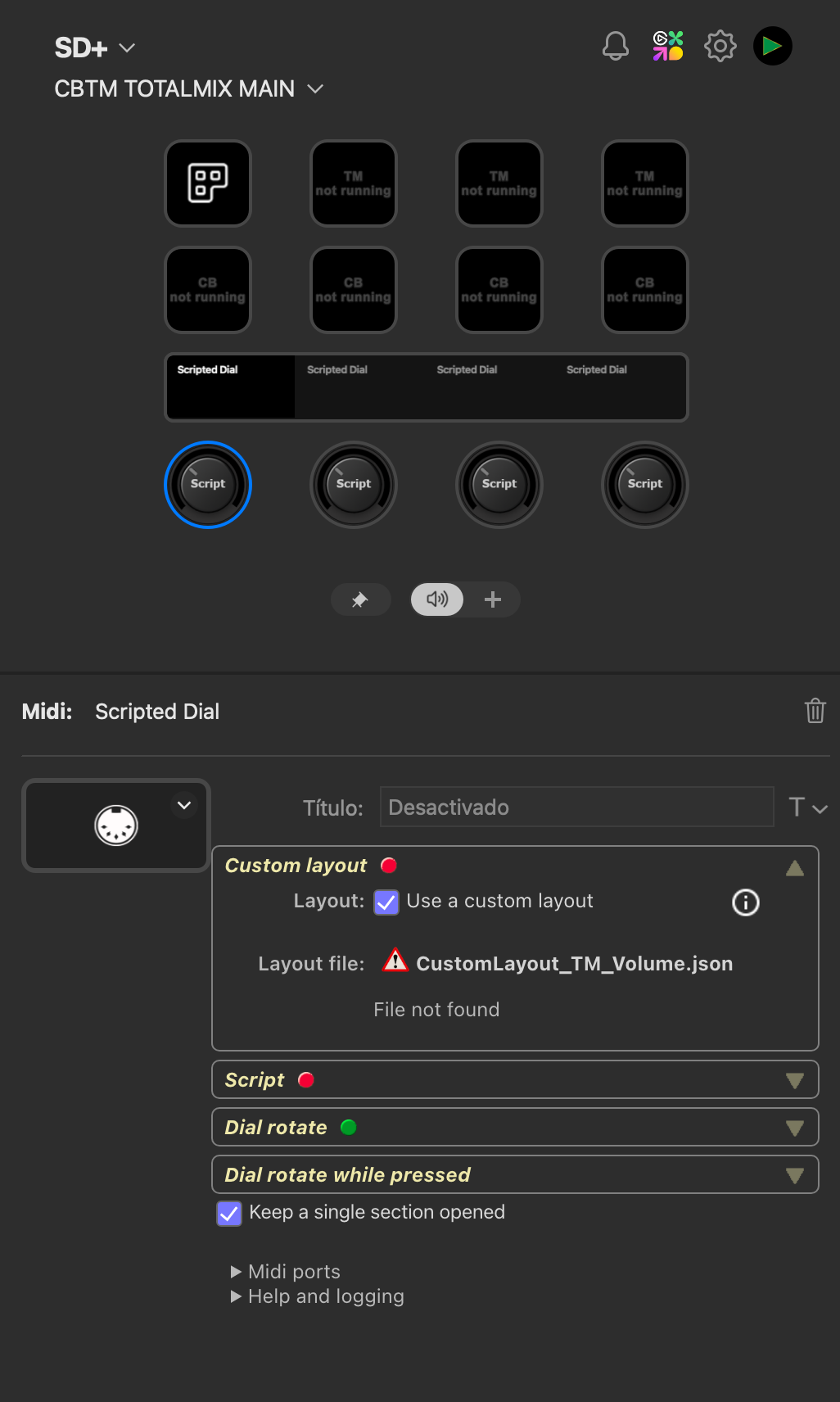

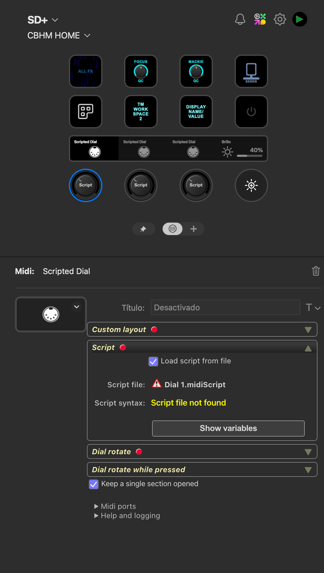

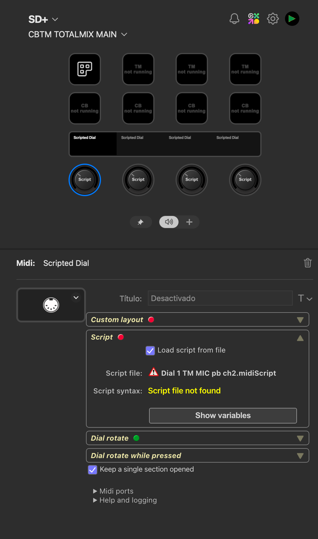

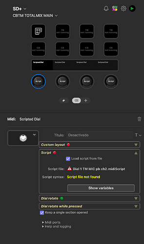

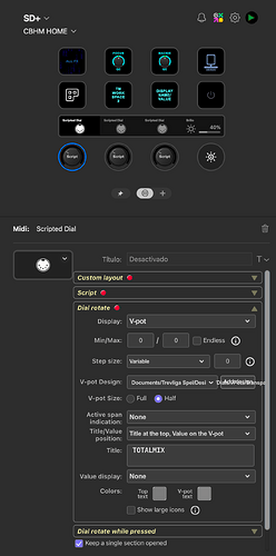

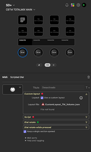

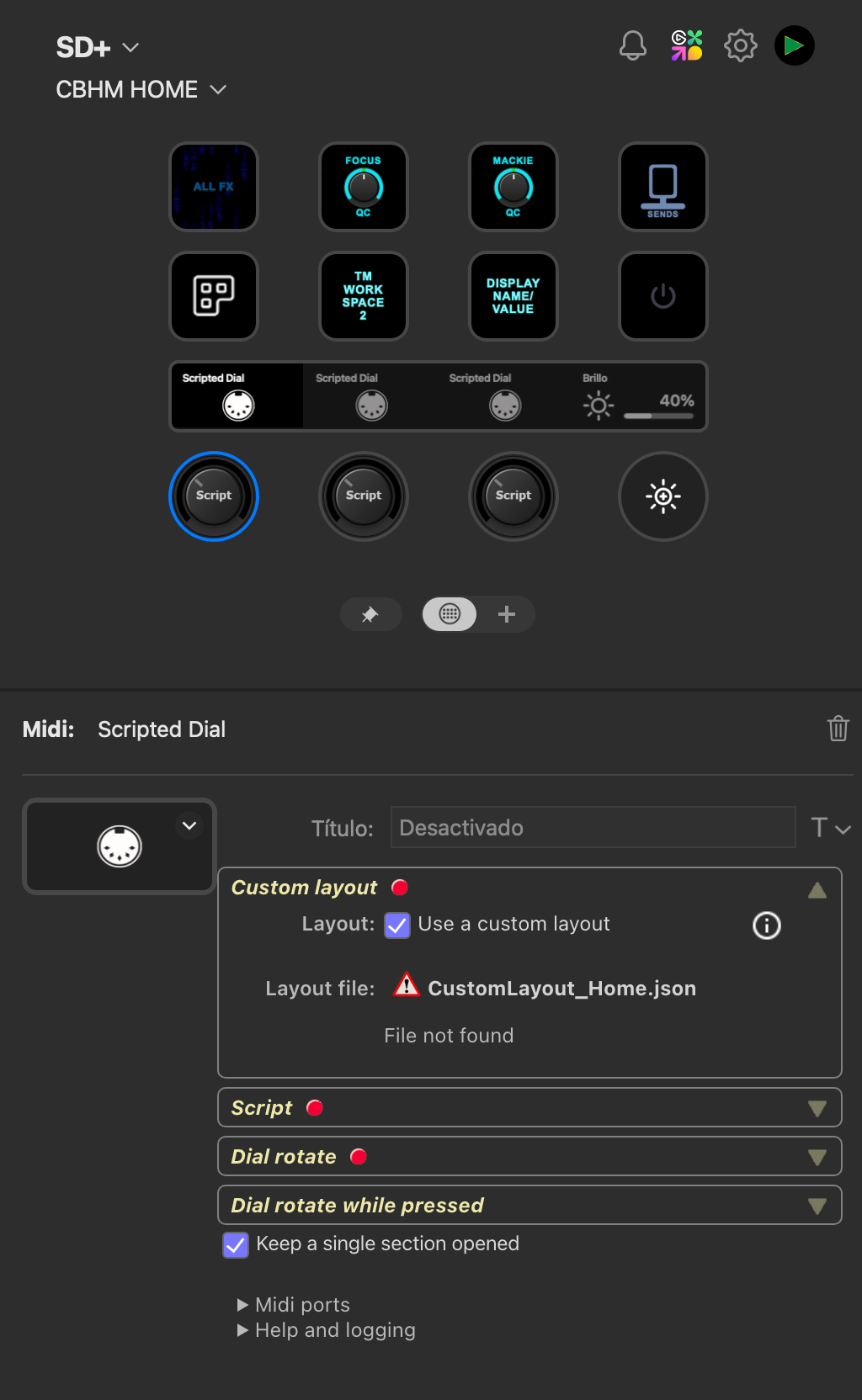

I have installed beta version 4.2.0.43 from last release version 4.2.0.4
After the installation, all my scripted dials were broken, showing errors regarding files are missing (script files, custom layout files, vpot designs, fadere designs).
Here are some screenshots:
I restarted the editor of stream deck (I didn’t unplug the usb cable from the device) and the issue is gone, all files are found by the plugin as expected.
That sounds very strange. In theory, there should be no difference between the first and second start of the plugin. But clearly, there are some differences. Does the log file provide any useful information?
