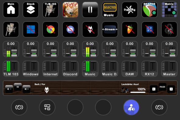

Fader on Streamdeck peak out
so yeah. i use Reaper and send the data via Loopmidi. on the screenshot it goes all to the maximum, in Reaper, nothing goes beyonf 0dB!

I don’t know which track maxes out, but I can’t see anything wrong in the log file.
The VU information in Mackie Control is very crude and only shows 12 levels, so the level in the plugin is not an exact replica of the level in Reaper. The plugin shows the values sent by Reaper. If those values are not explained by this 12-level approximation, the problem lies in Reaper; the plugin cannot (or rather should not) show anything other than what is sent by the DAW.
may be possible that the Fader design i have does not work for the Reaper ones
Fader design has nothing to do with it. If the DAW sends the max value of 12 for the VU level (as I can see in the log file that Reaper does), the plugin will show the VU meter maxed out regardless of which design you have selected.
If you tell me which track is maxed out, I can show you the values sent from Reaper.
Issue with the fader was on my end.
Reaper fader’s top is 0dB my fader (as you see on the screenshot up there) has 12 at the top
I redesigned the Faders for my Stream Deck, and now it is accurate (atleast the Level Meter)

OK, so the only problem was the numbers on the meter, not its level?
