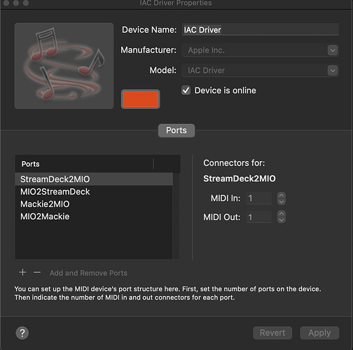

Hi there,
The MIDI plugin was working on my MAC mini (Apple Silicon, OS 15.1)

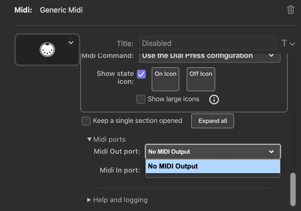

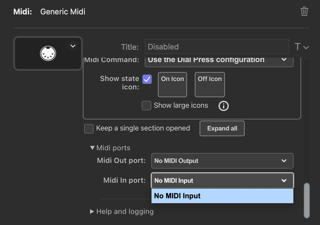

I took it out for a few days running a live show, when I’m back in my studio, the MIDI plugin suddenly not worked at all.
Both the drop down menus shows no midi input/output port. I tried to restart the Mac, re-install StreamDeck software, re-install MIDI plugin by clearing out the plugin folder. Nothing works…..
I’ve always had the IAC driver working with ports dedicated to StreamDeck, all of my other softwares can see the MIDI ports(UA MIDI Control, Ableton LIVE), only my MIDI plugin in StreamDeck could not see the MIDI ports at all.
Here are some screenshots attached below, thanks in advanced!

First, review the Global Settings and the Global Ports tab. At the bottom, if “Show only global ports…” is selected, choose a different option.

The Global Ports seems to solved my issue, many thanks!
