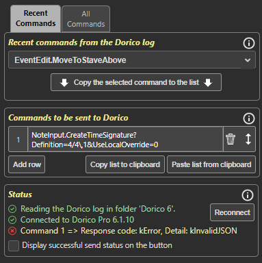

Problems with commands containing a backslash
If a command copied from the Dorico command list contains a backslash (“\”), it will not be executed and an error message will be displayed instead.

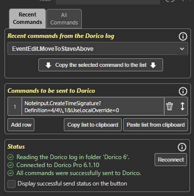

However, I can force the command to execute by replacing the single backslash (“\”) with a double backslash (“\\”) in the “to be sent” line.
(I tested this with the command for creating a pickup bar.)

Another finding:
Even with double quotation marks ("), which appear in Dorico commands, a backslash must be added before them when sending.
This is how I got a command to work that sets all four page margins to 10 mm:
Project.Layout.SetOptions?LayoutIDArray=0&Dictionary=list: {string: \“pageSizeAndMarginOptions.pageMargins.margins.outer\”}\\, {string: \“28.346457\”}\\, {string: \“pageSizeAndMarginOptions.pageMargins.margins.inner\”}\\, {string: \“28.346457\”}\\, {string: \“pageSizeAndMarginOptions.pageMargins.margins.top\”}\\, {string: \“28.346457\”}\\, {string: \“pageSizeAndMarginOptions.pageMargins.margins.bottom\”}\\, {string: \“28.346457\”}\\, {string: \“pageSizeAndMarginOptions.pageMargins.extraMargins\”}\\, {list: {string: \“28.3465\”}\\, {string: \“28.3465\”}\\, {string: \“28.3465\”}\\, {string: \“28.3465\”}}&OpenScoreID=0
