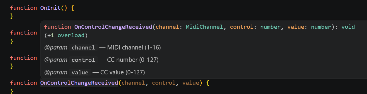

Two comments :
  • It would be nice to align the parameters description with what’s in the d.ts reference.
    In the above cases what is important is to know that midi channel is “one based” (1-16), for instance, and CC’s are 0-127.
  • Now it is a matter of taste but i’m not found of JSDoc in the js files (which are already much more verbose than midiscripts) and having a proper hover text on functions definition is sufficient in my opinion.
    I tried to get the proper hover from d.ts but I could not, as it seems that for callbacks, typescript intellisense has priority over d.ts content, and shows “any” for parameters types, regardless of the d.ts content.
    Maybe there is a workaround to this, using VS Code HoverProvider API that could source from the d.ts file … but i did not investigate further.

The duplicate function entry when typing “function myfunc” … could be resolved by duplicating each entry and changing the prefix to “function myfunc”, but it is not really usefull in fact.
  • hover on functions sourced from d.ts jdocs, so that we have a consistent signatures representation.
I’m not sure how to distribute but this is the solution recap with as many things as possible within a Trevliga Spel/JS folder - to be unzipped from a provided file, and some additional configuration in Code/user Folder: code snippets + one line to be changed in Code/user/settings.json

midi, ui, gvar… hover streamdeck-midi.d.ts auto-included by jsconfig
Callback hover (OnTimerElapsed…) node_modules\ts-plugin intercepts hover, returns typed d.ts signature

  • Typed hover for host globals (midi, ui, gvar…) — from streamdeck-midi.d.ts
  • Typed hover for callbacks (OnTimerElapsed, OnKeyPressed…) — via ts-plugin

Final setup:
Trevliga Spel\.vscode\ — all project tooling in one place:
  • settings.json — workspace editor settings
  • streamdeck-midi.d.ts — type definitions
  • streamdeck-midi.code-snippets — workspace snippets (auto-loaded)
  • node_modules\ts-plugin\ — TS language service plugin
  • update-vscode-settings.ps1 — one-time setup script per machine
JS\ — scripts only, no tooling artifacts. Each JS file references the d.ts via /// <reference path="../.vscode/streamdeck-midi.d.ts" />.
User settings (Code\User\settings.json):
"js/ts.tsserver.pluginPaths": ["C:/Users/<user>/Documents/Trevliga Spel/.vscode"]
This is the only machine-specific setting. Run update-vscode-settings.ps1 once on a new machine to set it.
Why pluginPaths can’t be automated further: it’s a user-only setting — VS Code intentionally blocks it from workspace settings for security. No variables (${userHome}, ${workspaceFolder}) are expanded there.
Zip file to be uncompressed in Trevliga Spel : Here.

This is what I see when using $(userHome):
function OnControlChangeReceived(channel: any, control: any, value: any): void, instead of the signature from the d.ts file, which indicates the hover is not working. With an absolute path I see the same thing as you.
However there is a workaround with the ps1 script, which will update with the absolute path (one-time setup script per machine).
