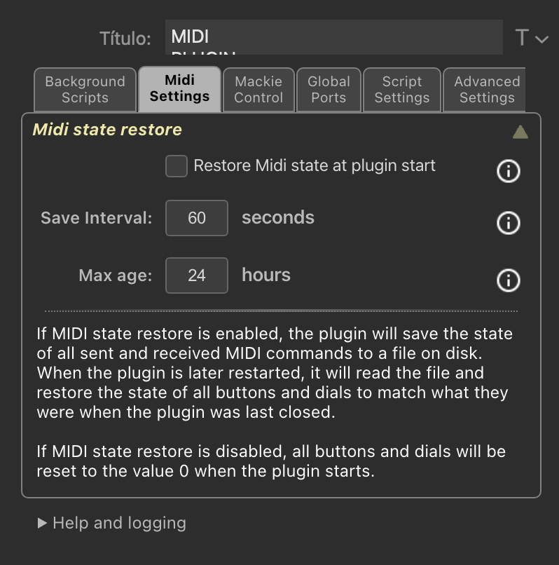

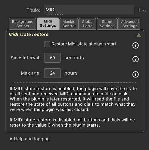

Version 4.2.0.66
Cosmetic issue: The tab “Advanced Settings“ is cropped (at least in macos version)

This update includes fixes for the JavaScript layout handling.
Global settings spacing should be better on Mac.
The MIDI system selection page has been modified to better explain the available options, and the MIDI connections are made more robust when switching between options.
It is made “release-ready” with a version info popup at first start.
