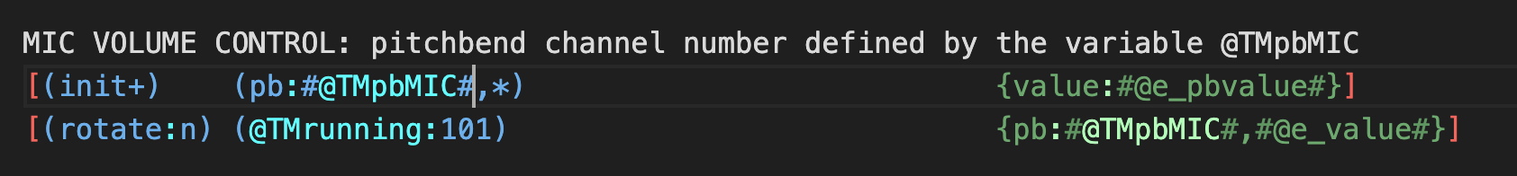

I have added the following code at the beginning of one background script, to define the default pitchbend value for an audio soundcard channel:
[(init) {@TMpbMIC:5}]

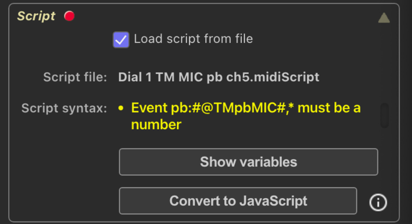

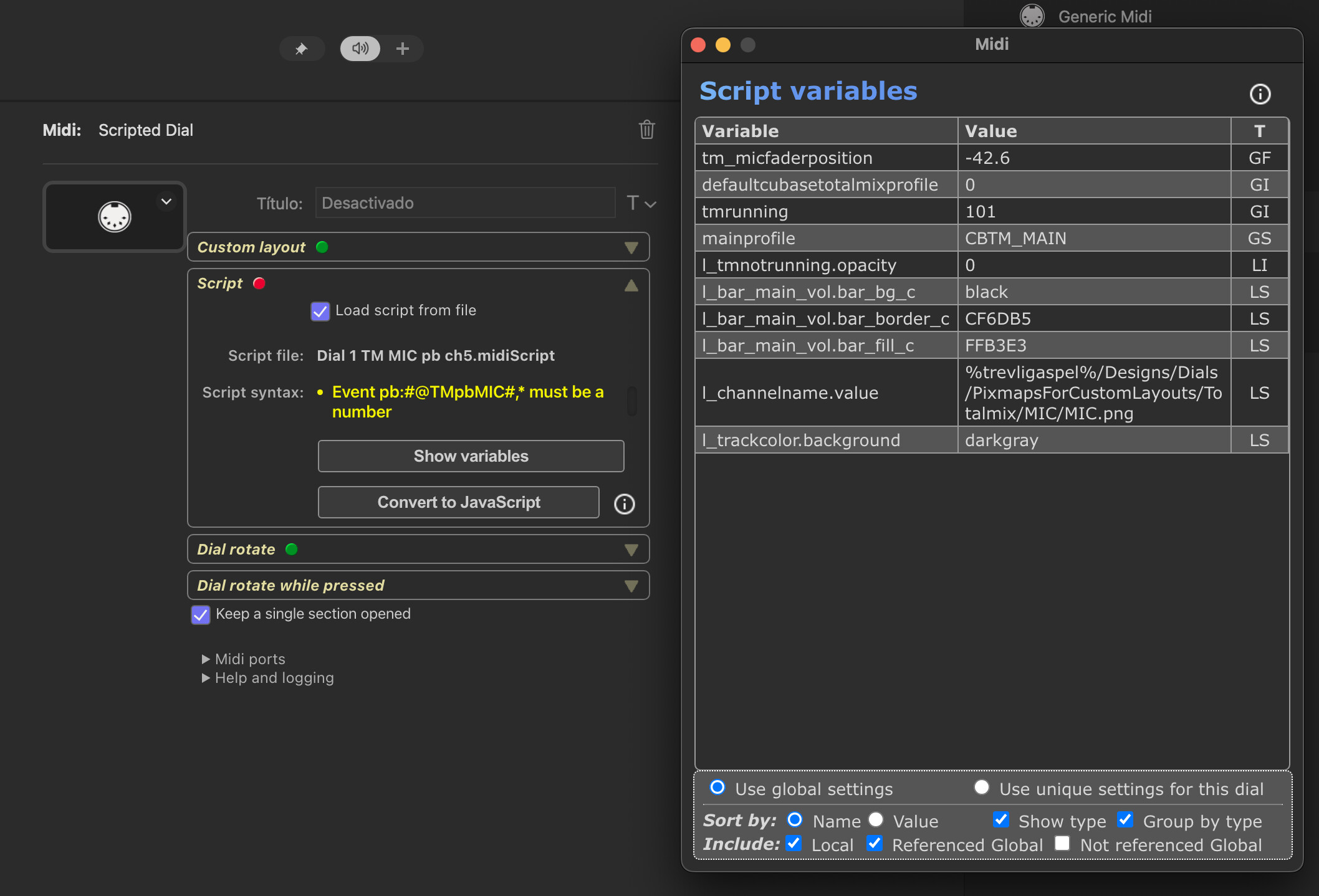

I have the Advanced Settings of the Midi plugin like this:

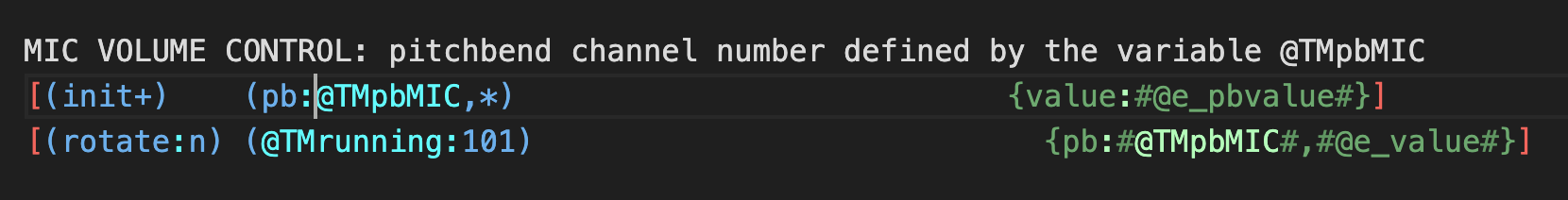

The following code gives the following error:
The error is fixed if I remove the ## from the pitchbend event:

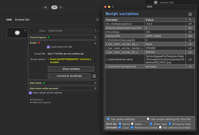

The other weird issue is that in both cases (with the error and wihout it), the variable “@TMpbMIC” is never shown in the Variables window when I select the “Referenced Global” option:
The variable “@TMpbMIC“ is only shown when I select the “Not Referenced Global“ option.
I have restarted the SD Editor and the issue of the variables window persists.
I have unplugged and plugged again the SD+XL and the issue of the variables window persists.

Yes, # characters are never used in events.
Found it. Variables referenced in events were not properly identified using lower-case, so the plugin didn’t recognize them as referenced.

Suggestion: If the midi plugin engine detects # characters in the events, show in the editor that these characters are not allowed.
Now it is sating “Event pb:#@TMpbMIC#,* must be a
number“ for this type of error.
It would be more clear to say something like: “Event pb:#@TMpbMIC#,* must be a
number and # characters are not allowed for referencing variables“

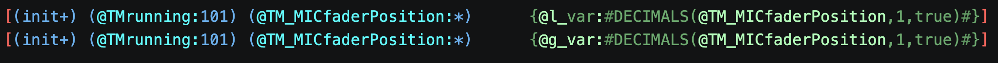

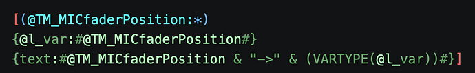

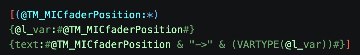

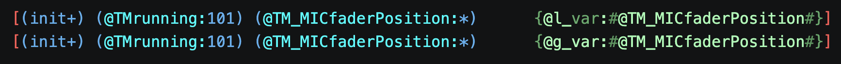

Let’s take this code, where the var TM_MICfaderPosition comes from a background script:
When I move the scripted dial and the value received is an integer, the l_var and the g_var are shown as floating vars.
In the other hand, this second code works as expec@TMrunninged:
Video of the 1st code:
Video of the 2nd code:
