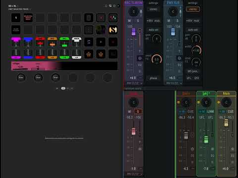

Some uppertext are not shown (as before). You will see in log and video that it happens to the first two paired buttons, which should show the names MIC and FM9.
Now, in addition, it seems that some midi values ​​(pitchbend in this case) are not updated correctly when the buttons are initialized. It happens in the same paired buttons (MIC and FM9).
Video:

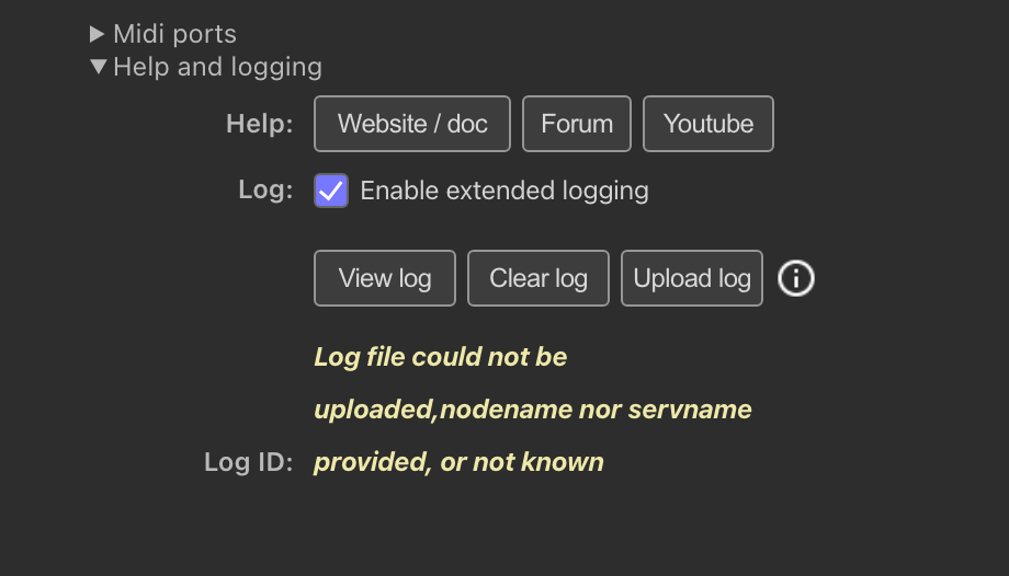

Temporary issue: Empty variables window. Fixed after SD editor reboot.
Uploading the log was not possible until reboot, with the following message:
Is “reboot” a computer reboot or a Stream Deck restart?
It’s hard to pinpoint the issue. Both errors likely stem from the same underlying problem, but it’s still hard to say what it is.
The upload problem is caused by an inability to perform DNS name resolution; the plugin cannot contact trevligaspel.se because it cannot resolve the site’s IP address.
The empty variable window is harder to explain, but I guess it’s also an HTTP/HTML issue. In essence, the plugin just asks the OS to open a second browser window and load an HTML file. Why the HTML file isn’t loaded remains a mystery.
So, both problems are in the IP/HTTP/HTML area, so I can only guess that’s where the problem is, but I can’t say more than that. The log file provides no more information than what was visible in the editor.

Should I revert to the previous version ?
Before doing that, I’d appreciate it if you could create the file “EnableLogging.txt” in the plugin folder and add the text “level2” to it. After that, restart the Stream Deck software, and post the log file again.
That way, we hopefully get a log file that explains what the problem is.
When that is done, you should revert to the previous version, since that’s probably the best way to get something working again.

Here is the log file after enabling level2.
