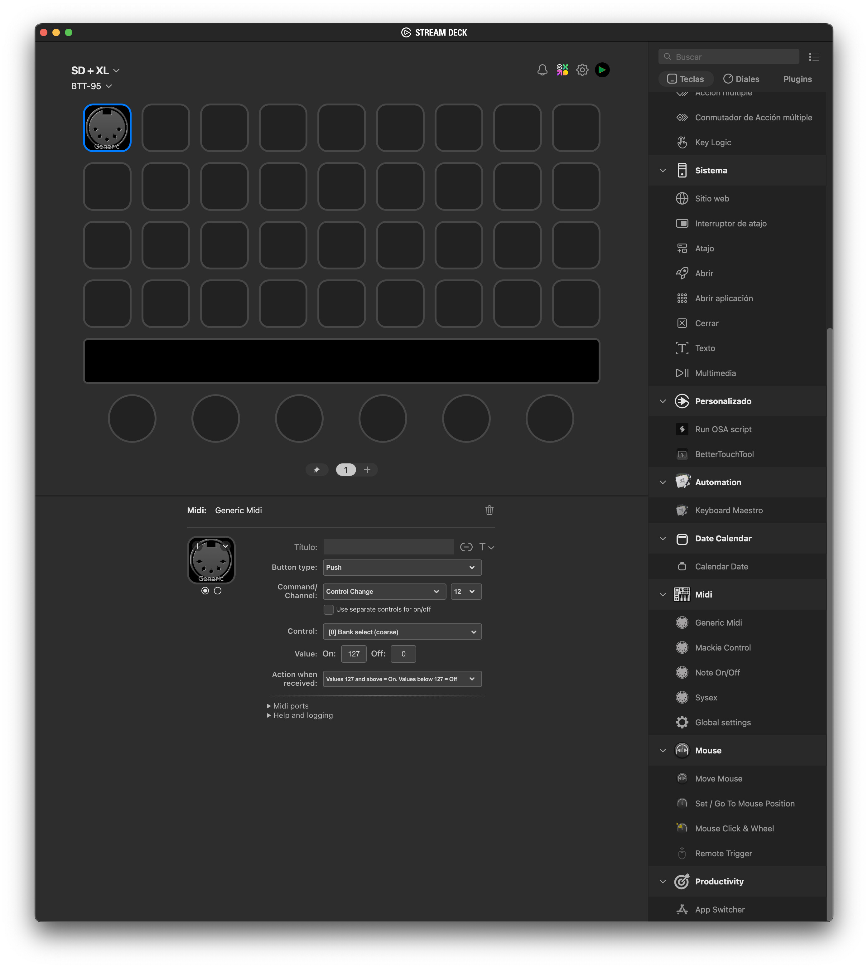

When I say “Stream Deck Editor” I mean the app “Elgato Stream Deck“. This:
I use the name “Stream Deck Editor” to differentiate it from “Stream Deck Device”.

For me, “Stream Deck Device” is of no interest. When you connect/disconnect a device, just about nothing happens; all buttons and dials remain loaded in the Stream Deck software, and you can still edit everything in the editor.
The important difference is “Stream Deck Editor” vs “Stream Deck Software”. If you open/close the editor (i.e., the window), nothing happens besides the window opening and closing. When you restart the Stream Deck software, “everything” happens.

Video:
Log should describe the behaviour shown in the video.
Everytime I restart the Stream Deck Software, the ports of the background scripts are configured to ports GP11 and GP12 (the ports that I manually put for testing).
Once the Stream Deck Software has been launched, I press the “Run(init)commands“ button of every background script. They are set to the correct ports.
But when the Stream Deck Software is quitted and launched again, the ports are restored to GP11 and GP12.
