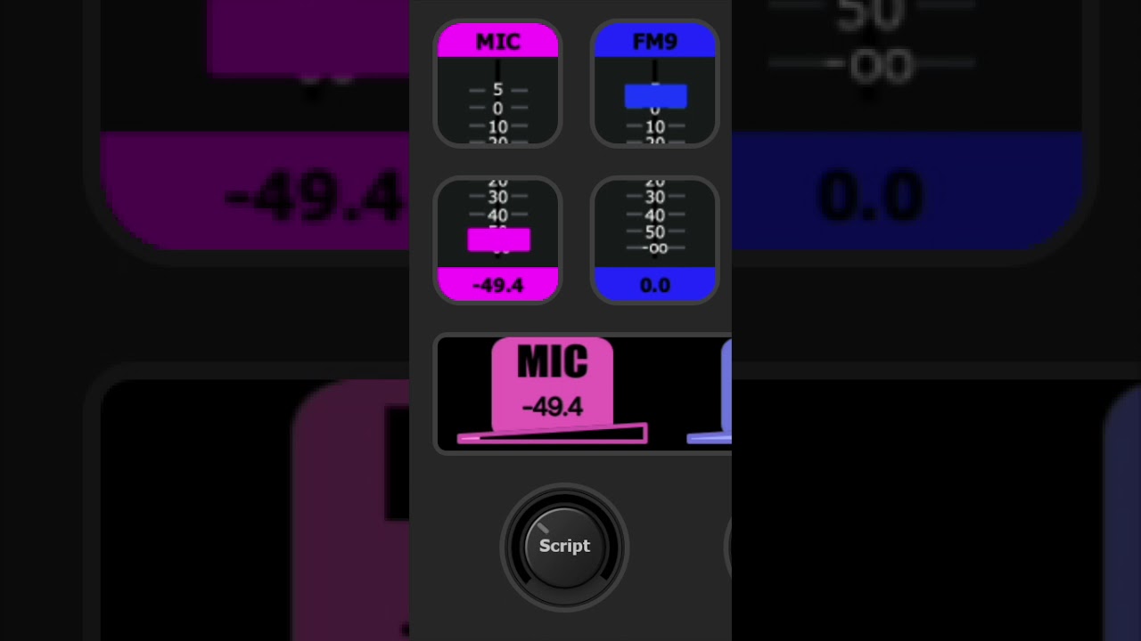

I’m experiencing another issue with scripted paired fader buttons compared to scripted dials.
In the next video you can see that the numeric values ​​are correctly centered on both the button and the dial.
But when the text is “-oo”, the button shows it off-center while the dial shows the value correctly centered.
The code of the script is the same for both the button and the dial:
[(init+)(@TM_MICfaderPosition:*){text:#DECIMALS(@TM_MICfaderPosition,1,true)#}]

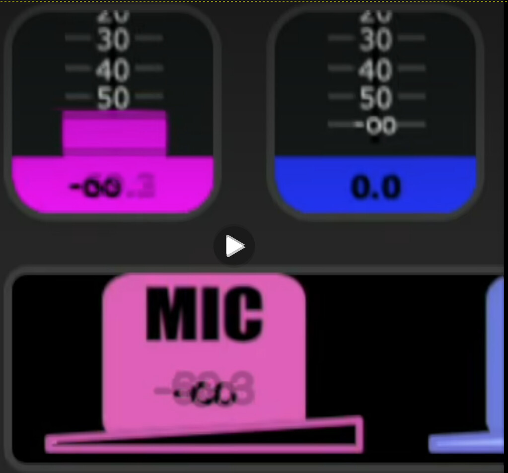

Yes. In both cases, the plugin tells the rendering software to center the text. For dials, that is the Stream Deck software, and for buttons, it’s the graphic subsystem (SkiaSharp). I don’t know why SkiaSharp is rendering the “-oo” off-center; it’s as if the text were really “-oo ”, but that shouldn’t have made a difference, I think.
This image shows the different values overlaid on the button, and it’s obvious that the text appears left-justified in the center area, if you get what I mean. Unfortunately, I can’t do anything else but say that the text should be centered.

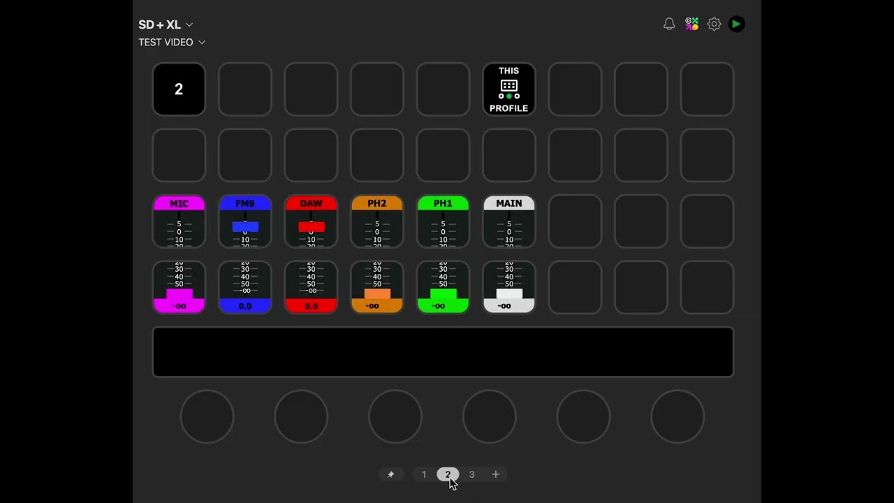

At the beginning of the video I switch pages 1 and page 2 to refresh the page.
At the end of the video I press several times “THIS PROFILE“ button to refresh the page 1 of this profile.

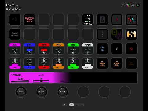

If I remove all scripted dials and the rest of buttons, the issue is fixed.
Maybe the problem is the qty of information that the plugin receives?
See this video with only scripted paired fader buttons:
I found it, and it’s related to the number of items that need to be initialized in the profile.
When a button is loaded, (init) commands are not executed immediately; they are delayed by 0.2 seconds to allow things to stabilize before running. The lower button is loaded first. When the issue occurs, the 0.2-second timer expires before the upper button is loaded, causing the (init) commands to be executed and the {textupper:…} action to fail.
I need to add a sync so the (init) commands are not run until the upper button has loaded.
