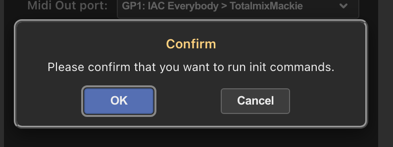

  1. About the “run init commands” confirmation dialog, have you considered whether to keep it or remove it?

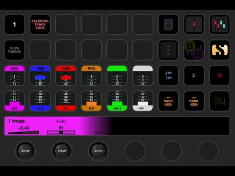

I am experiencing an issue with some scripted paired fader buttons that I have recently created. This is the first time I use scripted paired fader buttons in my setup (previously I only used them for beta testing).
Sometimes the text of some upper buttons is not shown.
At the end of the video I press twice the change of the profile that contains the paired fader buttons and it seems to fix it. (EDIT: IT fixes sometimes, randomly)
This is the video:
