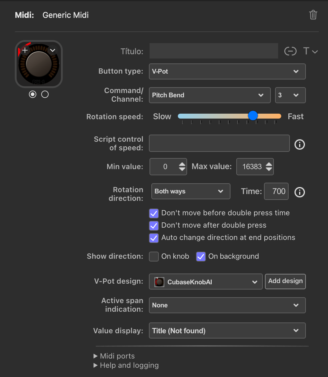

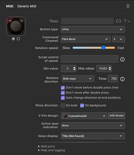

I can’t find how to show a title in button>generic midi>V-Pot/Scrub Wheel:
It seems that the option Title is not available like we have in button>generic midi>fader.
Is this by design or a bug?
A bug by design, maybe. :rofl:
The title option is explicitly coded to be available only for faders. If you have a fader selected with the title options enabled and then switch to something else, you will see ā€œTitle (Not Found)ā€ displayed.
It’s not only the dropdown option that is ā€œmissingā€; there’s no code to handle the title field for anything other than faders.
I don’t remember why it’s designed this way, and I have way too many other things to take care of to get this version released, so this issue will get low priority.

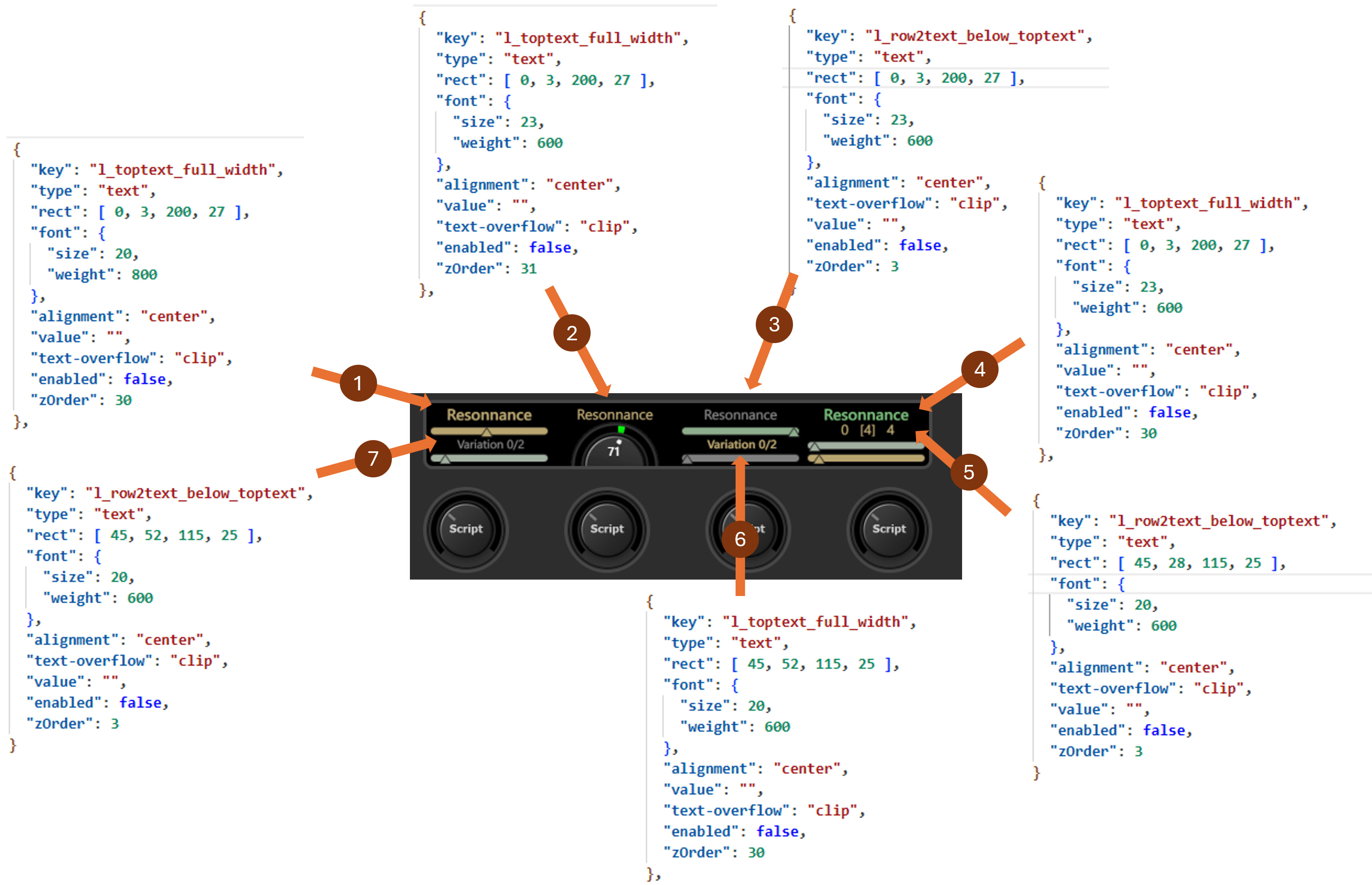

Now i’m having a hard time understanding the display logic.
This what I set and what I get :
In summary :
1, 2 and 3 should be identical, they are not
5, 6 and 7 should be identical, they are not
Some of them a bold and some not, for a reason I don’t understand.
I have also noticed that Changing the font size and weight in the layout files has almost no effect.
Log ID : 504fcd6e-e3cf-43bd-9e2f-4011f4fd7ba5
I’ve also seen that they are some ā€œstrangeā€ calculations in the log regarding font sizes and available spaces. What is the logic ?
… and is the a way to have those fonts and text sizes identical ?
Thanks for your hard work.
Font size and weight in the layout file are mostly ignored. The plugin adjusts the font size so the text fits in the available space. Font weight is somewhat random (obviously). Once upon a time, I found that in some color combinations (text/background), the text needed to be bold to stand out better. So the text weight is calculated based on the colors, in a way that probably seemed logical at the time, but I can no longer explain it.
These weight calculations were made during the button-only era and were carried over to the dials, obviously not consistently, and probably not even necessary. :roll_eyes:
The logic behind font sizing is to ask the graphical subsystem how much space the text will require. A loop starts with the largest available font size (available in the editor text popup) and reduces the font size step by step until the text fits within the rect defined for the text. The calculation isn’t exact; there are edge cases where characters may be partially outside the rect to avoid further reducing the text.
With scripted dials, yes. Font size and weight set in a script always take precedence, and the automatic calculations are ignored. For other dials, unfortunately, not.

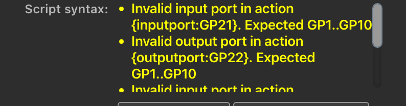

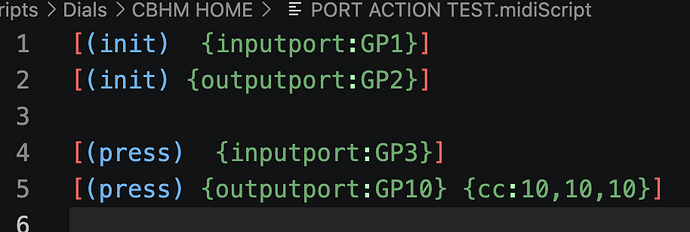

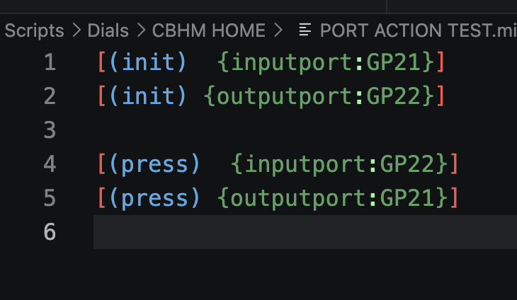

ISSUE 1
The actions for changing ports are giving errors when you want to use ports higher than 10:

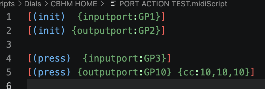

ISSUE 2
The {inputoport:GPx} action works as expected if you use GP1-GP10. There were no problems in the first tests.
But the {outputport:GPx} action is not working even you use GP1-GP10. It always shows the global port as not present in the editor. It is not only a cosmetic issue. It is not sending any midi message:
After running init:
After press:

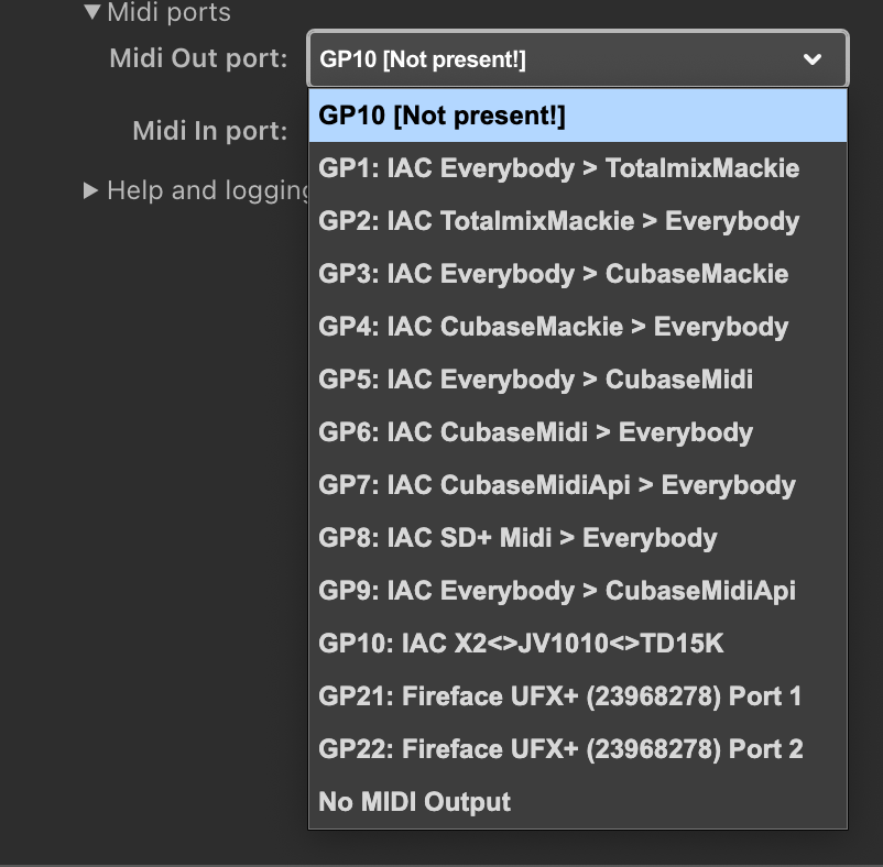

The dropdown menus shows this:
